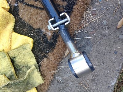

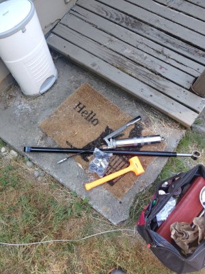

I got this adjustable track bar from Iron Rock Off Road, thought I would throw some photos of it here. Shipped the same week, shipping was like 30 dollars for the cheapest option. Kind of spendy item, feels heavy duty though. Weighs probably twice as much as the stock one. Not sure if that is either here or there...
I put it in but I honestly have no idea how to adjust it so taking it in to a shop for an alignment.

With the track bar off, on level ground move the body back and forth some and let it settle in
Measure on both sides from one point to another that is the same way both sides
Then install new track bar, adjust to those measurements
Not much to it really, just take a little bit of time to make sure you're equal

The IRO track bar looks beefy and good quality. I have a JBA one, which is awesome also, but unfortunately they stopped making lift components.
