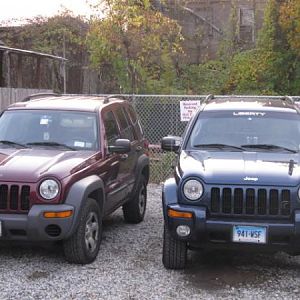

Both are 2002 Limited’s. 3.7 auto, Renegade light bars, lifted, full power heated leather, sun roofs. The silver is 4:10 gears with rear locker.
