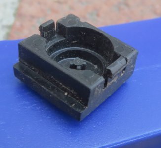

Step 4 : With the face plate removed, the tow/haul button is now exposed and can be messed with. The clips retaining the tow/haul button are vertically positioned and can be squeezed to free the button itself. Once the button is free, I took the plastic wedge, and gently pushed against the small piece you see in the middle of the button. This, combined with pressing the button a few times, freed the button up and revealed to me that the spring inside of the button was still mechanically working. There was a bunch of dust that started to slowly make its way out of the spring as I continued to press the button!
Step 5 : Once you've determined whether or not your switch is still good (Turn on the car, press the button, see if the cluster responds with the respective tow/haul light activating. If not, maybe you will need to research further :(. But... if you're lucky, as I was, you should now begin to reassemble the parts the opposite way in which you removed them in this little recap!
Replace button and ensure wiring is routed corrected for tow/haul button > replace face plate for gear shifter and ensure little blue strip is not removed > replace the 4x4 wiring harness, put the car in neutral and ensure all 4x4 options are working correctly > if all works, replace the outer plastic housing and the shifter knob. Viola! All done.
