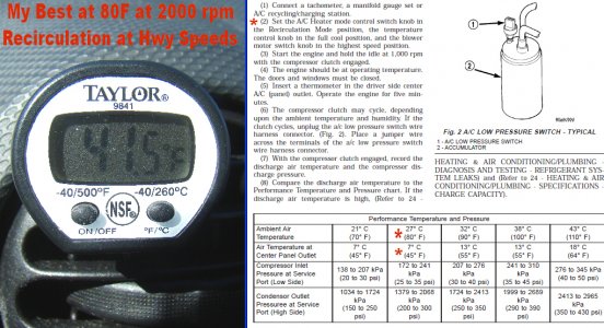

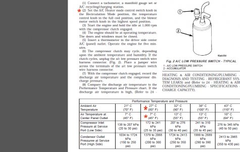

Not sure if you need to re-charge your AC? Here is the way to test.
Turn your temp setting to cold (right dial)
Set to re-circulation setting.
Run 5 minutes at 1000 rpm..reading within spec? Mine is dead on.
