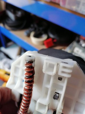

Hi folks, my passenger side rear window has been fallen for a month or two, I've been keeping it up with a wedge of wood inside the door and am finally getting around to fixing it.
I assume what failed is the clip thing that I've seen a metal replacement for kicking around this forum. What is the best way to actually confirm what has failed inside the door? its very hard to see around inside the door and I'm unsure exactly what has failed, all I know is the window pretty much moves freely in the bracket
Also any advice on replacement parts best to use these days?
Hi Just made all my window work on 2006 Cherokee. All were defunct. 2 windows had hole glass type. Awkward to get at, but get the glass to base of door you should see the plastic horror on the window, hole type. Plastic locator fits in hole so you have to push it back whilst lifting the glass off it. It dodgy? Get glass up to top and gorrilla tape it up. Then get the actuator assembly out. Great fun that. I got bored waiting for spare plastic part on the other side, non hole type? So bodged wonderfully. After few glasses of vino, but still works
I wired the cable where the plastic. Was drilled a few holes wired it. Araldite the rear. Wire used from Bubbly wire closure
Its tough in the UK
