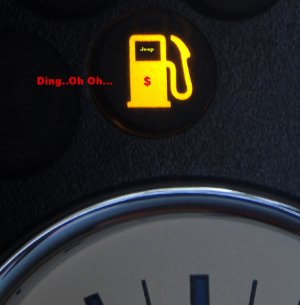

I drove my Jeep a few days ago, wasn't paying attention... thought I had enough fuel.
Suddenly this happened.."PIG"
