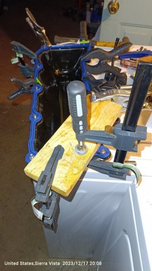

Ya I've done that but since my last post I think I've figured out what's wrong. The back end of the blue gasket with the ridge in the middle is the problem. Hard to explain but the length of the gasket between the two back bolts/fasteners , is a millimeter or 3 too long thus not allowing the gasket to sit 100% on the cover.
So now as I write I have put a slight bead of permatex on the cover ,then clamped the gasket to that bead with every clamp I could find.
It's sitting on the bench curing over night.
So I'm hoping that that's the solution, and it's pretty sad that the gaskets that are being suggested by all the major players for vehicle specific applications are not being thoroughly vetted.
I'll follow-up tomorrow
