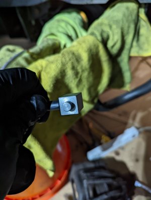

I purchased a kit online awhile back and was able to keep it with a full refund when I found out it was cannibalized by the seller (a stealership no less). I know it's missing banjo bolts and clips, but today, I noticed the part that connects to the hard line looks a lot different (see pics). It's missing a bracket that secures it to the wheel well. Wondering if that tab is there to attach one that's missing from the kit or something else? Thanks!

Yes, you are missing and e clip and the tab. That allows it to bolt up to the factory location. I broke one e clip during my installation and substituted it with some wire to retain the bracket.
