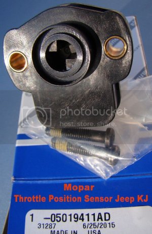

So I had no choice as the Jeep was running like an ole bucket, but to buy an OEM Mopar TPS.
54709[/ATTACH]"]

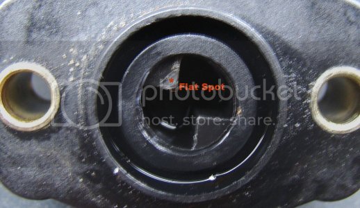

The old sensor was chewed up a bit..
54711[/ATTACH]"]
and live data graph scan may have shown the exact interior fault position.

You do turn the TPS slightly clockwise to align the interior throttle tab, holding it inwards, then swing it back counter clockwise 1/4 inch aprox, to now tighten bolts back in.
