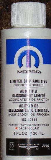

If your Jeep has a Trac-lok limited slip rear diff, a 4 oz bottle of mopar fluid needs to be added as well.
You can get your build sheet here & see if you have Trac-Lok rear diff: https://www.jeepkj.com/threads/build-sheet.64657/
