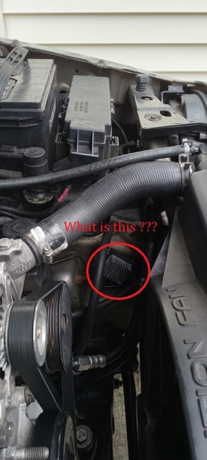

"Mysterious heat sink block".
Does anyone know what this is and why it is necessary? The location is the inside wall of the left front wheel well, under the power distro center (fuse box).

9,099
That block is the voltage regulator.
Live data from a shop that has a Snap On modis ultra shop scanner can view random or particular misfires etc..
Ok, that's excellent news. Is it an after market gizmo that isn't necessary, and can it be removed safely? If other 2003 Liberty 3.7s have the block, and no misfires, then I'm neutral... but if this is a "nice to have for the benefit of some garage mechanic", I would like to minimize extraneous circuitry in the effort to get to the root cause of this cyl4 misfire problem. Thoughts?
