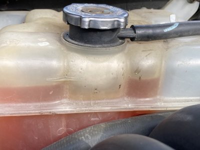

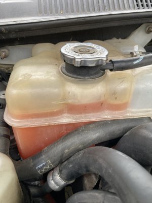

I've been having a similar problem and hope you will keep posting as you work through this. Thanks! I did run some head gasket sealant through the system and it has slowed down the leak, but not stopped completely. Just like you, no milky oil, no apparent leaks, no white exhaust, etc.
WHAT STOP LEAK IS BEST TO US E i HAVE THE SME ISSUE ON MY V6 liberty 3.7 and its right now a very slow leak in the revivor.. but I tried Kool stop pour and go and it helped a little but now I hear you got to run it for 1/2 hour wit the cap off is this true

Do not use ANY stop leak unless you want to replace everything in the cooling system
Worst product ever , will stop up the heater core, gets into water pump etc

Thank you ,Ill have to check more around the hoses.
