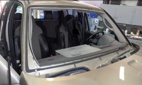

Another issue the was I had was the windshield leak that was dripping down behind the dash an onto the fuse box and relay panel. After I replaced fused one, the windows worked again but if I hit the horn the fuse would **** again. Seems like the relay for horn was blown. Replaced it for $8 and now everything is working....oh yeah had to get the windshield fixed as well. Thanks again!

Did you have to get the windshield cut out and then re-sealed? Or was it just back filled from outside?
In my case it was re & re & then it still leaked. So I used silicone as the back fill all around, no leaks now for 5 years. :)
