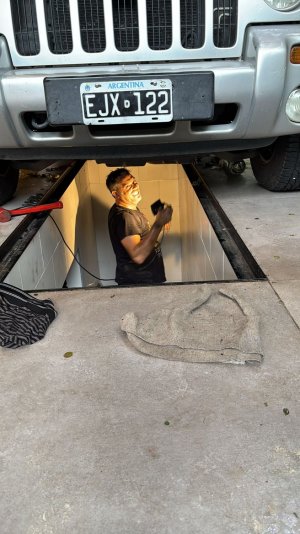

Meet me me yesterday, doing the thing...
