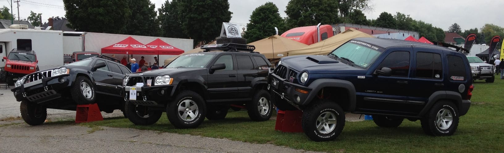

A man installed a 33-inch tire with just a 2-inch lift.
