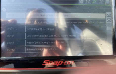

Hi All. Advice needed to avoid chasing my tail in circles. 2008 Kk limited 128k became posessed a few days back.
While driving around town, wipers on / off automatically, dash lights flashing on/off like Xmas tree, tach and speedo drop to zero and then kick back on, and radio kicks on & off all while driving.
Now running fine. No gremlins present
Alternator was replaced a week prior. Battery (interstate) installed 1/2023. Aftermarket radio w/ canbus adapter installed 1/2023.
Pulled codes. See pics. Codes cleared, and ill see what returns. FYI no check engine light on.
Any thoughts or tips / tricks? A faulty BCM or does TIPM need refurbishing?
Thanks in advance.

These Jeeps do all kinds of random things if the voltage is low. I would unhook the battery to reset the computer again, and get the battery tested. It is possible that the battery is not holding full power since the alternator died and stressed it out.

Good idea. I haven’t thought of that assuming battery is relatively new.
