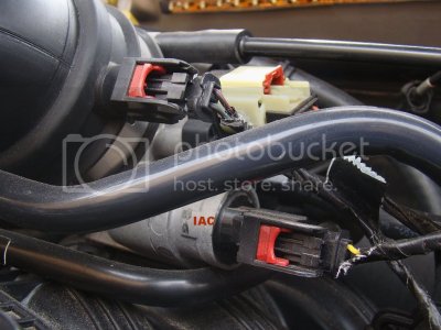

The IAC controls rpm. They get seriously carboned up. Drivers side of Throttle body.
Remove it and give it a good cleaning and the port with throttle body cleaner spray and see if that is better, if not replace it.
Also spray out the throttle body, and check your air filter.
38677[/ATTACH]"]
One - T-20 Torx bit on bottom (behind hose) remove it...
38679[/ATTACH]"]
38681[/ATTACH]"]
38683[/ATTACH]"]
38685[/ATTACH]"]
38687[/ATTACH]"]
38689[/ATTACH]"]
38691[/ATTACH]"]
You sir, are a god! Thank you so much!!!!!

I have both the throttle body cleaner and Carb Cleaner.
The throttle body cleaner should be used as an intake cleaner as is safe for injectors/cats.
Ok so why in the photo did I mention Carb cleaner? Simply it works better, is stronger, and in the case where you have removed the IAC and are only using Q-tips and lint free shop towels to clean the port, the carb cleaner removes the carbon better.
Some compressed air (even in a computer dust off spray can) helps to blow out the small particles and should be used after cleaning as well. Hope that helps.
And Edit: One Last comment on the plunger on the IAC, When you depress the plunger, the Q-tip should bend a bit and there should be reasonable resistance as you depress it.
If it slides down like the spring does not exist, replace the IAC. A sign that the plunger is worn out is : a hesitating idle like sticking at 850rpm and then dropping to 650 to idle normal as example.
ALSO since you are there and cleaning take the time to also remove your PCV valve! Clean it too and if it does not rattle..buy a new one!!!
And last hint for removing hoses..use a hair dryer to heat them up before removing and installing.
