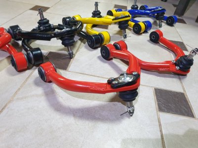

Yes, you're right, the ultimate goal - installation of larger wheels 265/70/17, with the replacement of gears and adaptation of the transmission (I have a diesel), now more details - the springs are these vlad-springs.com, the upper front levers analog JBA https://jeep4x4club. ru/forums/topic/47394-analog-verhnih-rychagov-jba-gruppovoy-zakaz/page/14/#comment-1663771, photo attached, behind me already have 3. 5-4", are hockey washers, ome shock absorbers with expansions, the necessary H132L did not find in the free market, expanded adjustable transverse linkage, the question of how to properly raise the front and alignment, yes forgot to say the front expanded Teraflex bumpers are on the way.
