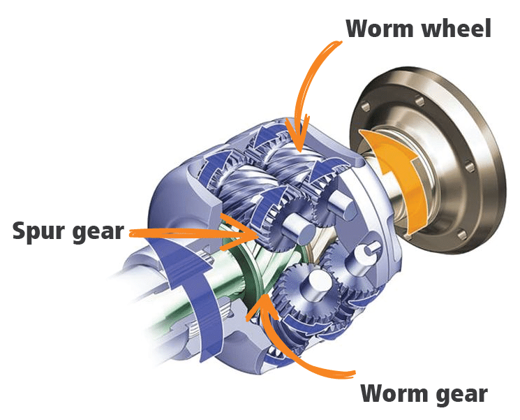

Please note that with a helical (DTT) style locker you won't get any lock up on if one tire on the axle with the DTT is in the air. I would imagine this will be limiting for rock crawling type off-roading, but not a problem on flatter ground.
From KMP Drivetrain:
"Please note that the wheel with grip receives 4 times the grip the other wheel can transfer to the road. It does not mean 100% of the engine torque can be used. Let’s say the engine puts out 300 Nm of torque and the spinning wheel can only transfer 50 Nm of torque to the surface it is on. In a regular open differential, the other wheel would receive 50 Nm of torque as well. The total amount of torque to the wheels is 100 Nm. In a Torsen differential with a 4:1 bias ratio, the other wheel will receive 200 Nm or torque. The total amount of torque to the wheels is now 250 Nm."
