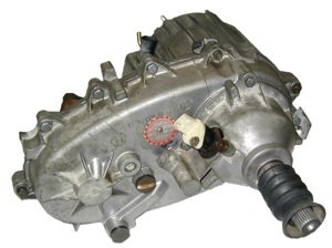

There is a reason the factory did not combine those two ( manual transmission and select trac )
Select trac is not build to handle the manual trans , not heavy enough
of course people have done it, heck people jump off bridges all the time but it's still not a good idea
Years ago we took 2 wheel drive XJs and installed 4 wheel drive in them since it was very easy
Too many electronics, different computers etc anymore to make it worth while
Mr. Bluphant's tutorials ????? never heard of them or if he knows anything
Sorry, I call B.S. The 242 is just as tough if nit tougher than the 231. JEEP even offered them with 4.7 L V-8 engines in the 1999 - 2004 Grand Cherokees. They were also offered in V-8 powered Dakotas and Durangos. The 4 in the series number actually means a stronger unit that ones with a 3. So go ahead, it will be fine as long as you di not plan on burning donuts all day long.

Glenn Dickson
Apr 6, 2021
Offered, .... but still not that strong for the abuse that some put a manual through
We had this discussion many times at my monthly M&Gs with both engineers and the guys who actually built the KJs
( Yes they'd come out to my place and hang out )
They all always agreed and said the same things, it was just not strong enough to hold up behind a manual
period

Here is a link to what I have always heard about 231 vs 242 T cases.
Glenn Dickson
Apr 6, 2021
Hummers used them as well.

Oh well I tried but some have to learn the hard way
just have to walk away and laugh ! LOL
