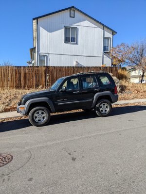

I did not add anything besides the lift and 245/75r16's with a pounded pinch weld. Rides like it's on rails! I have noticed a small power loss with the larger tires, but nothing serious. Here's a photo with the new tires on.
