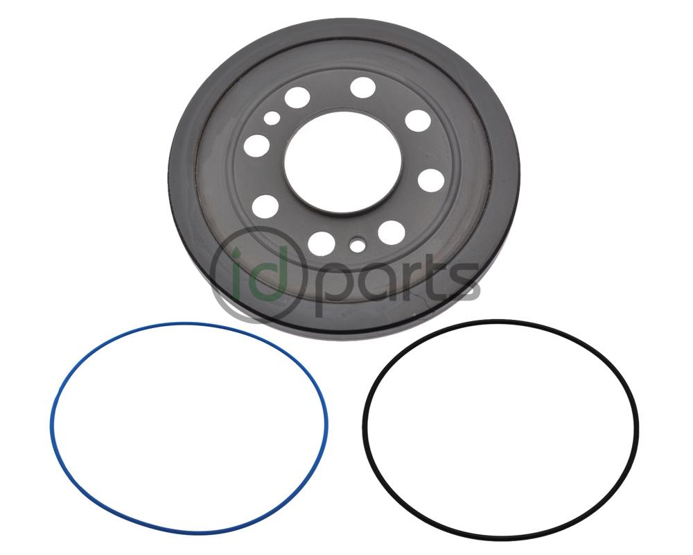

Hi, I've replaced my rear oil seal and the rear thrust bearing (recommended because it's right there when it's stripped). It's a bit of a scrabble without a lift , basically it's the same as a transmission removal to just get it out of the way and then a bunch of bolts. I got the seal and bearing here :
My jeep had around 230k at the time and was dripping an embarrassing amount of oil over everyone's driveways lol. After the change it took a couple of weeks to settle in and completely stop any leakage. Hoping for 400k.
