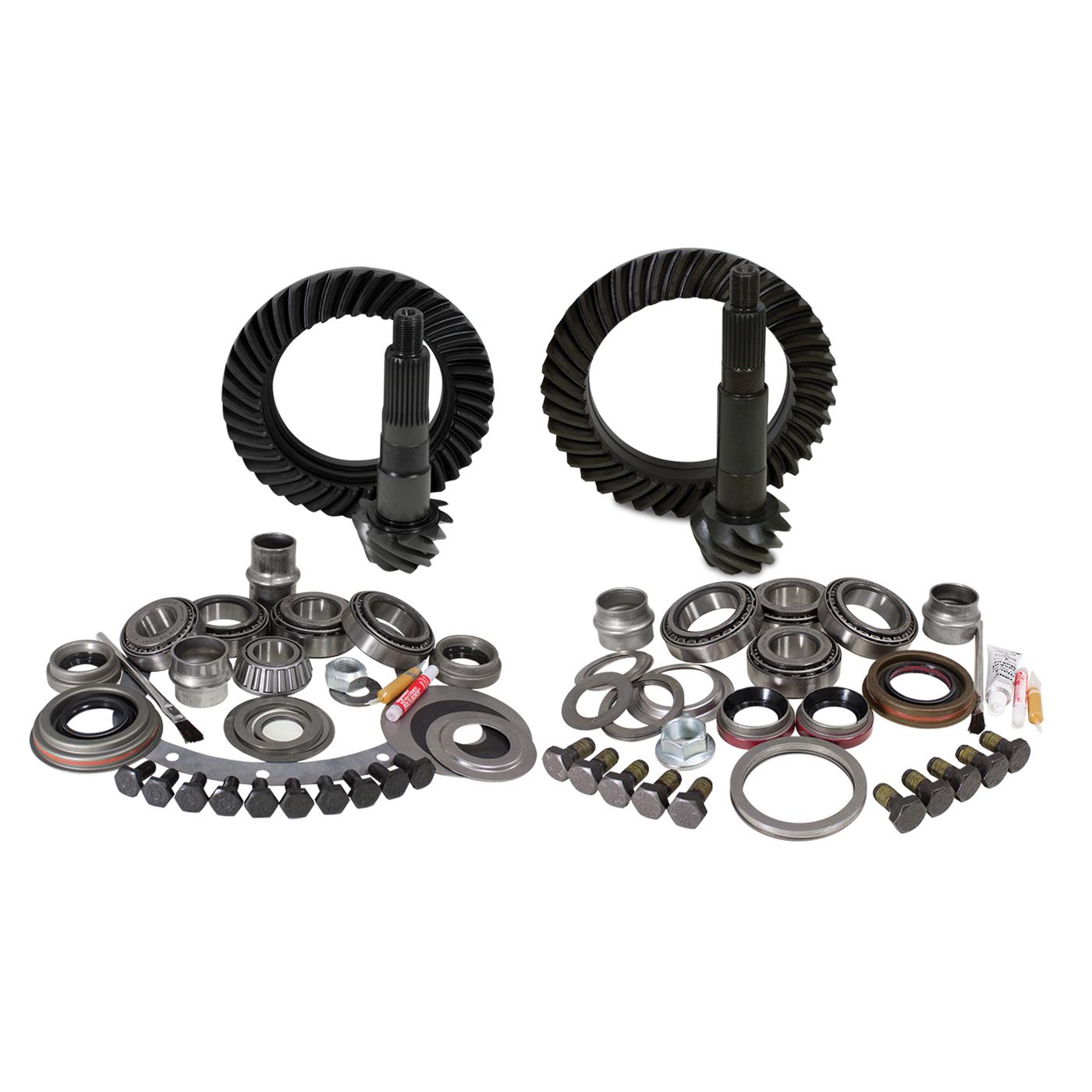

Hey guys! Looking to get this thing reheated and I am struggling to find a rear end and a front differential locally with a 4.10 gear ratio.
Summit racing does have some gear sets for a Dana 30 and Chrysler 8.25 combo. But these will not work with the Dana 30a, correct? Or are the housings, carriers, ring and pinion the same between a Dana 30 and Dana 30a?
JRB
May 27, 2021
263
263
WPB, Florida
Pinion different, so r&p will be 30a specific.
differential appears to share between the 30 and 30a, as they don't make a specific separate one for the 30a that some recently talked about.
