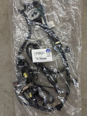

However, while I was replacing the pump, I saw that the wiring connecting to the fuel pump looked pretty janky like the previous owner had spliced it before, pics attached below.

1. could damaged wires give the u1411 code?
2. what fuel pump wiring harnesses are compatible with a 2006 KJ?
On mopar, it's listed as part number 56047848AB, but it's discontinued and I can only find the connector with the wires cut on ebay.
I'd want to replace that whole segment vs splicing it again, and any advice is appreciated!
