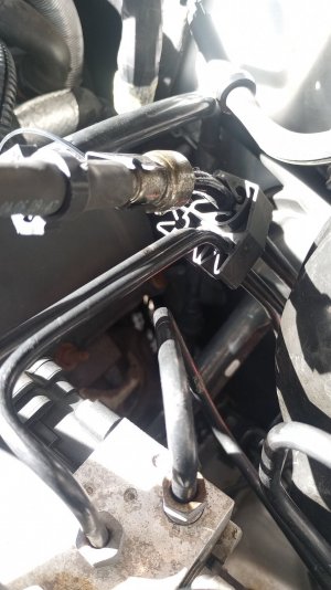

Well I never would have guessed this one. Started smelling gas every single time I drive the jeep. Thought maybe something had happened at the fuel tank and the filler neck since it started right after I got a full tank put in. Nope. It's apparently the jumper line from the fuel hard line to the rails. It's leaking at the fitting on the hard line. Just weeps enough that when it's running for a bit it'll drip. Really kind of scary because the exhaust manifold is not too far from there!

You can even see the drip forming in this picture.
